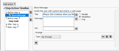

Wow, the workframe for
  1.  a window informs the user that some manual steps are necessary.
       "Please click OK when you finished the manual steps".
  2. ...
  3. after clicking on OK, the workflow will continue with the next step.
is already there:
A MODELESS window, which pauses the execution of a Scripted Workflow .
Amazingly useful - many many thanks to the invetors : )
