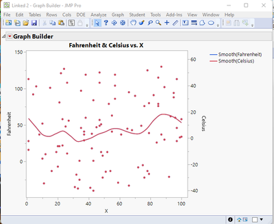

Hello everybody,
I'm quite new to JMP and have a question regarding plotting your data. Assume you measure a variable that can have different units (e.g. wavelength and energy). I would like to plot the data with one scaling on the left y-axis and the other on the right. I tried inserting a "Formula"-column in the graph builder and move it to the right axis. But that doesn't really do the job, because the axes aren't linked that way.
Thanks for your help!

Here is an example where the left and right axes are linked in Graph Builder  All that is needed is to add a simple script to Graph Builder which checks for changes either the left or right axes and then resets the linked axes.

gb = Graph Builder(
	Size( 528, 454 ),
	Show Control Panel( 0 ),
	Variables( X( :X ), Y( :Fahrenheit ), Y( :Celsius, Position( 1 ), Side( "Right" ) ) ),
	Elements(
		Points( X, Y( 1 ), Legend( 14 ) ),
		Smoother( X, Y( 1 ), Legend( 15 ) ),
		Points( X, Y( 2 ), Legend( 16 ) ),
		Smoother( X, Y( 2 ), Legend( 17 ) )
gbr = gb << report;

Hello thank you very much for your solution. In general it works, there is only one bug I'm facing: when changing the scale using the mouse key, the axis labels start to flicker. Do you have an idea where this may come from?
txnelson
Re: Second Y-Axis with different scaling
I suggest you unselected your "hardware acceleration" for your graphics
