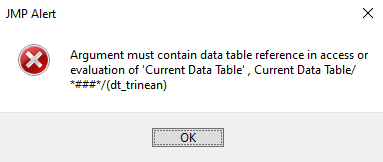

How to write a script to standardise attributes of columns from a generic data table?
I am trying to write a script which standardises attributes from a generic data table. However, I getting the error "Argument must contain data table in access or evaluation on 'Current Data Table', Current Data Table*###*/(dt_trinean). Does anyone know hoe to fix this error?
vince_faller
Super User (Alumni)
Re: How to write a script to standardise attributes of columns from a generic data table?
the only variable you're giving to the local block is old dt.  Then you're using dt_trinean.  Instead of switching current datatables, it's often better to scope the data table expicitly.
Thanks, it worked by modifying the script as below:
Local( {dt_trinean_lst = Current Data Table()},
	Current Data Table( dt_trinean_lst );
	For Each( {col, index},
		{:"A280 Concentration(mg/ml)"n, :"AvgA280 Concentration (mg/ml)"n,
		:"CVA280 Concentration (%)"n},
		col << Data Type( Numeric ) << Set Modeling Type( "Continuous" ) <<
		Set Field Width( 12 )

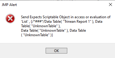

Now I want to get the summary of replicates on the concatenated table dt_trinean_lst. The code below throws this error, could you tell why and how to fix it?
dt_trinean_summary=dt_trinean_lst << Summary(
	Group( :Sample name ),
	Mean( :"A280 Concentration(mg/ml)"n ),
	Mean( :"AvgA280 Concentration (mg/ml)"n ),
	Mean( :"CVA280 Concentration (%)"n ),
	Freq( "None" ),
	Weight( "None" ),
	Link to original data table( 0 )
because it's a local variable so once you leave the local block. that var doesn't exist anymore.
For example.  This will fail after printing.  "inside local = 14"
Names default to here(1);
open log();
Local({x=14},
	print("inside local = "||char(x))
print("outside local = "||char(x));
