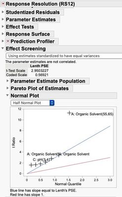

3. It appears the terms removed from the model and replication of the 6 center points is what is being used for the estimate of the MSE for statistical tests (again, without run order are these replicates or repeats?). This variation (the removed terms, which can bias the MSE) is very small in comparison to the total variation, hence why so many terms in the model look statistically significant (especially Capacity and Retention). There is a mention of within day and between day estimates of precision. I do not see day accounted for? So the question is, is the variation of the removed terms and the replicated counterpoints representative of the true variance (random errors) in the process? If I look at a Normal plot and use Lenth's PSE, it appears the RMSE may be under-estimated (note: JMP labels estimates according to RMSE, not PSE)
