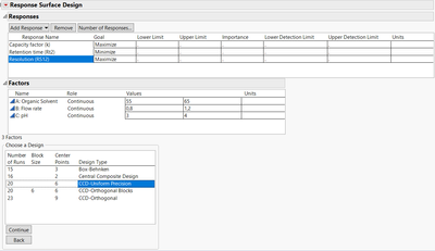

In order to create a similar design, you can go in "DoE" menu, then "Classical" and "Response Surface Design".
You can then specify the 3 continuous factor and 3 responses.
Then you have the choice between different designs :
The CCD with Uniform Precision does contain 6 centre points, like in your example.

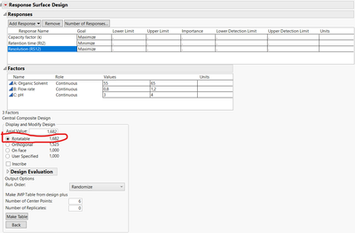

Then, select the axial value corresponding to rotatable design (1,682 for 3 continuous factors) :
And you'll end up with a similar design to the one you have shown. Here is the script to generate the design :
