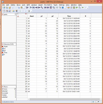

I found a query that would solve the second case.  I added 6 rows at the bottom that duplicate the max times for each asset, plus added an X variable.  Here is the table:

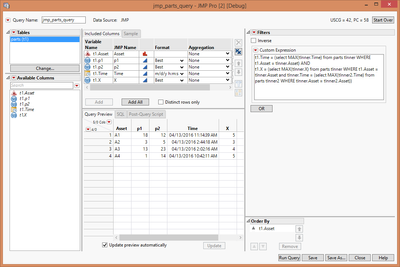

And here is the query that works (it requires one subquery and one subquery within a subquery)):
The custom expression is:
t1.Time = (SELECT MAX(tInner.Time) FROM parts tInner WHERE t1.Asset = tInner.Asset)
AND
t1.X = (SELECT MAX(tInner.X) FROM parts tInner WHERE t1.Asset = tInner.Asset AND
   tInner.Time = (SELECT MAX(tInner2.Time) FROM parts tInner2 WHERE tInner.Asset = tInner2.Asset))
I capitalized all the SQL keywords to make it easier to read.  I tried some simpler queries, but they did not work.
HTH,
Eric

Running the original version with only Time and using the MAX aggregation on X can be made to return the correct rows, but you will not be able to find out the values of p1 and p2 for those rows.  If I do what you said leaving p1 and p2 in the query I get all the rows with the duplicate max times, because p1 and p2 become GROUP BY's for the query:
Now, if I take p1 and p2 out of the query, the query returns the correct rows:
but the whole point was to find the values of p1 and p2 for those rows, and they are gone.  So I think the double subquery approach is the only approach that answers the question you asked.
Eric
