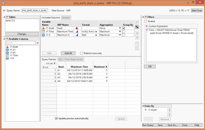

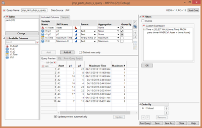

Running the original version with only Time and using the MAX aggregation on X can be made to return the correct rows, but you will not be able to find out the values of p1 and p2 for those rows.  If I do what you said leaving p1 and p2 in the query I get all the rows with the duplicate max times, because p1 and p2 become GROUP BY's for the query:
Now, if I take p1 and p2 out of the query, the query returns the correct rows:
but the whole point was to find the values of p1 and p2 for those rows, and they are gone.  So I think the double subquery approach is the only approach that answers the question you asked.
