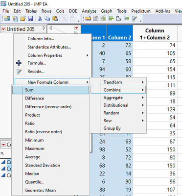

Hello @Terri_Denver. Make yourself a simple data table.  I created two columns and asked JMP to generate random integer values in each.  Then simply use the instant column formulas to take a sum.
What you can see here is that yes!  JMP can sum across the rows of a data table. Specifically, my instant column formula was generated using the "add" function in JMP.  Easy peasy.

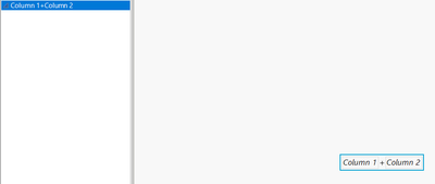

I can even use the "event recorder" new in JMP16 to save my script and share it here with you so you can reproduce it easily:
// New data table
// → Data Table( "Untitled 206" )
New Table( "Untitled 206" );
// New column: Column 1
Data Table( "Untitled 206" ) << New Column( "Column 1",
	Numeric,
	"Continuous",
	Format( "Best", 12 ),
	Formula( Random Integer( Empty() ) )
// New column: Column 2
Data Table( "Untitled 206" ) << New Column( "Column 2",
	Numeric,
	"Continuous",
// Change column formula: Column 1
Data Table( "Untitled 206" ):Column 1 << Set Formula( Random Integer( 100 ) );
// Change column formula: Column 2
Data Table( "Untitled 206" ):Column 2 << Set Formula( Random Integer( 100 ) );
// Add rows
Data Table( "Untitled 206" ) << Add Rows( 100, At End );
// New formula column: Column 1+Column 2
Data Table( "Untitled 206" ) << New Column( "Column 1+Column 2",
	Numeric,
	"Continuous",
	Formula( :Column 1 + :Column 2 )
 @PatrickGiuliano
