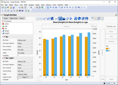

I have a question regarding value label offsets which I have not been able to figure out. I have a script which generates a lot of bar graphs with 2 Y variables and then another Y variable below. All of the Y variables should have label values. However, I am putting a hard axis max on the Y axis of the top two variables so that in some cases the bar tops would be cut off. Thus the label value would not be visible.
I want to have the labels be somewhere close to the Y=0 line or slightly offset from it. Something like the image attached
I am using JMP 16 but will be getting 18 soon so solutions for both are welcome.

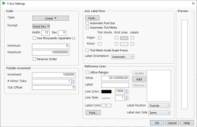

One thing you could do is to add second Y-axis on the right side (add to same Y-axis first and then right click -> move to right) and then make maximum Y value very large on that. Disable labels for left side and leave them enabled for right side.
Then hide the axis from right side
