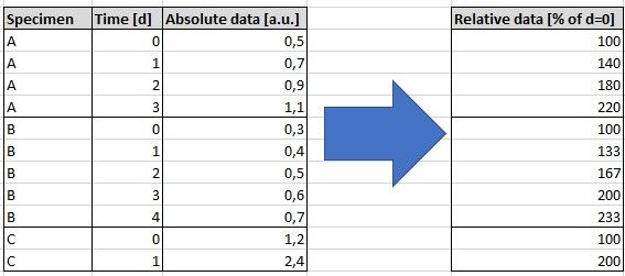

Hi, that's an interesting point. Before I open a new thread, may I bother you with a question? I am trying to achieve the calculations indicated by the blue arrow in the picture attached. This is stacked data for 3 arbitrary specimens with different results over a varying number of days. For each of the different specimens I want to convert the absolute results to relative results where d=0=100% for each specimen. I think my problem is that I don't know the terminology well enough for what I want to do. Would you be able to help?

Here are 3 different formulas that will calculate your needed answer.  The first one finds the d0 row for the given specimen based upon Time[d] = 0, while the second finds minimum of Absolute data [a.u.] for the given specimen.
Also, the formula rounds to an integer in each formula.  If you want more precision the Round() function can be removed and the column format adjusted to not allow decimal places.  The third calculated column used the JMP percent standard of the value of 1 being displayed as 100% by using the Percent format and specifying no decimal points.
I have attached my example data table.
Relative [% of d=0]
curSpecimen = :Specimen;
theRows = Current Data Table() << get rows where( :Specimen == curSpecimen & :Name( "Time [d]" ) == 0 );
d0Row = theRows[1];
d0Time = :Name( "Absolute data [a.u.]" )[d0Row];
Round( (:Name( "Absolute data [a.u.]" ) / d0Time) * 100 );
Relative [% of d=0] with assumption
Round( (:Name( "Absolute data [a.u.]" ) / Col Min( :Name( "Absolute data [a.u.]" ), :Specimen )) * 100 )
Relative [% of d=0] using JMP formating
d0Row = theRows[1];
:Name( "Absolute data [a.u.]" ) / d0Time;
