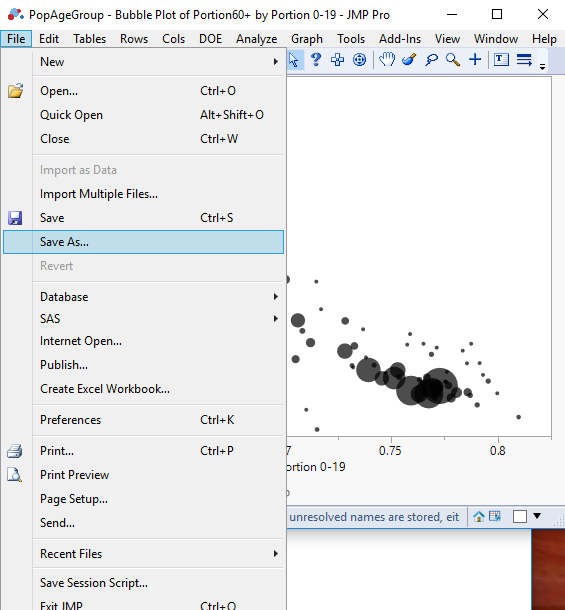

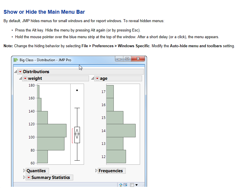

On your Bubble Plot output, the pull down menus are hidden, the image below will tell you about that
So if you click on the bar, the pull down menus will appear, and you can select

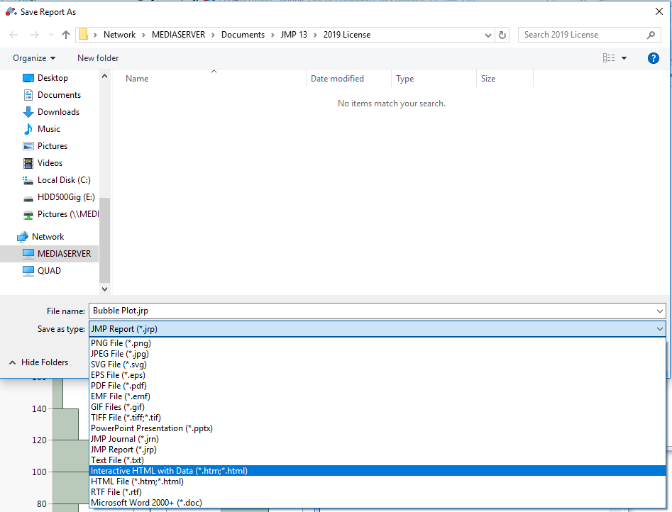

     File==>Save As
When the Save As window pops up, you then go to the drop down arrow for the "Save File Type" and select "Interactive HTML"
If you do not have the option on this screen to select Interactive HTML, then I suspect you do not have a current version of JMP
