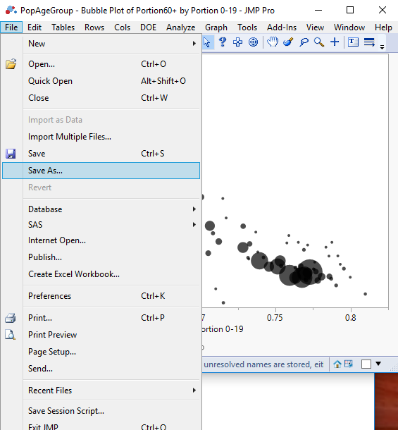

  1. Click on the Display Window the Bubble Plot is in.
  2.  Go to the "File" pull down menu option and select "Save As"
    1. You may not think there is a list of Pull Down menus at the top of the Bubble Chart window, but by default, in JMP, they are hidden until you click on the small bar that goes across the top of the window, just a bove the Outline Box that has the title of the chart.
  3. In the Save As window,  click on the down arrow at the right side of the "Save as type:" line at the lower part of the window, and select, "Interactive HTML"
Jim

gail_massari
Re: How to save JMP graph to interactive html file
After you have created the Bubble Plot (Graph>Bubble Plot) form the main menu FILE>SAVE AS and change SAVE AS TYPE to Interactive HTML with Data.
