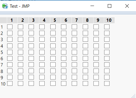

      I have a m by n Table box of check boxes. I am wondering, how I can set some of them selected.
          LB_b = Lineup Box(N Col(1));
	  nR = 10;
	  nC = 10;
	  SCB1 = String Col Box( "", {} );
	  For( i = 1, i <= nR, i++,
			SCB1 << Add Element( Char( i ) )
	  TB1 = Table Box( SCB1 );
	  For( i = 1, i <= nC, i++,
			Insert Into( TB1, Check Box( Repeat( {" "}, nR ), <<Set Heading( Char( i ) ) ) )
	  LB_b << Append(TB1);
	  T = New Window("Test",TB1);
        When I look at the tree structure, I wonder why I am unable to access the elements. I tried  something like the following  with no luck. Also, the goal is not to be able to select a column of check boxes, but a single checkbox in the matrix.

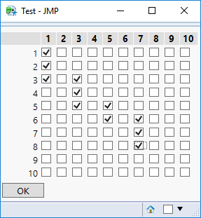

Here's a way to do what you need:
n = 10;		// # rows
m = 10;		// # cols
a = 1::n;
// Create a list of empty text fields as checkbox labels
cb_list = {};
for (i = 1, i <= n, i++,
	cb_list[i] = "";
cbmat = j(n, m, 0);
// Create the window
nw = new window("Test",
	tb = table box(
		ncb = number col box("", a),
	okb = button box("OK",
		for (i = 1, i <= m, i++,
			for (k = 1, k <= n, k++,
				cbmat[k, i] = cb[i] << get(k);
		show(cbmat);
		nw << close window;
// Create an array of checkbox columns
cb = {};
// Add the checkboxes
	cb[i] = checkbox(cb_list);
	cb[i] << set heading(char(i));
	tb << append(cb[i]);
cbmat =
[	1 0 0 0 0 0 0 0 0 0,
	1 0 1 0 0 0 0 0 0 0,
	0 0 1 0 0 0 0 0 0 0,
	0 0 1 0 1 0 0 0 0 0,
	0 0 0 0 1 0 1 0 0 0,
	0 0 0 0 0 0 1 0 0 0,
	0 0 0 0 0 0 0 0 0 0,
	0 0 0 0 0 0 0 0 0 0];

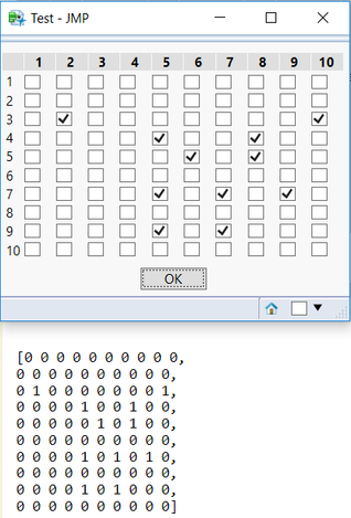

         I think @pmroz  's response provides a way to index to the checkbox, but I think it references them by column, not so much by each individual check box. I will try and illustrate in a little more detail what I seek:
         The snippet I posted gives me a matrix of selectable checkboxes like so:
         Now, should a user make his selection, I am able to unload the selection using the following:
NW = New Window("Test",
					VLB0 = V List Box(Align(center),
									  LB_b
VLB0 << Append(
				H List Box(
								BB_TargetMatrix = Button Box( "OK",
																ResMat = {};
																// loop through each row
																		ResMat[i] = {};
																		// loop through each column getting values
																		For( r = 1, r <= nC, r++,
																				ResMat[i][r] = TB1[CheckBoxBox( r )] << get( i )
																ResMat = Matrix( ResMat );
															)// end of button box
							 )// end of H List Box
           However, I would like to know how I can the table box with some of the checkboxes pre-checked. I have a matrix the same size as the table box, which I would like to use to set the checkboxes checked.

pmroz
Re: How to index into a table box of check boxes
This code will set the checkboxes from a saved matrix of 1s and 0s.
// Set some random values in this matrix
saved_cbmat =
[	1 0 0 1 0 0 0 0 0 0,
	0 1 0 0 0 0 0 0 0 0,
	0 1 0 0 0 0 1 0 0 0,
	0 1 0 1 0 0 1 0 1 0,
	0 0 0 0 0 0 0 0 0 1,
	0 0 0 0 0 0 0 0 1 1,
	0 0 0 0 0 0 0 0 1 0,
n = 10;		// # rows
m = 10;		// # cols
a = 1::n;
cb_list = {};
	cb_list[i] = "";
cbmat = j(n, m, 0);
	tb = table box(
		show(cbmat);
		nw << close window;
cb = {};
// Preload the checkboxes from the saved matrix
		on_off = saved_cbmat[k, i];
		cb[i] << set(k, on_off);
