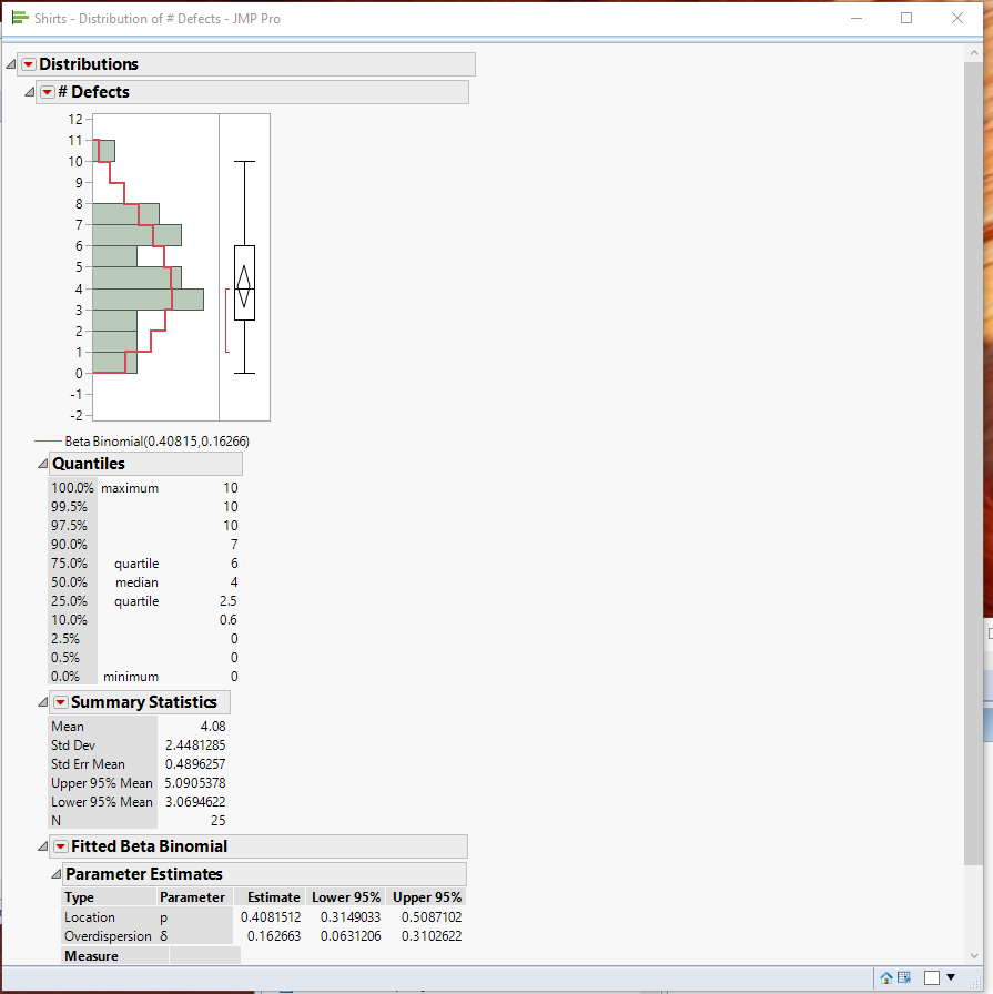

txnelson
Re: How to re-size a report table in JSL?
Are you just trying to set the window size like the below example?
Names Default To Here( 1 );
dt = Open( "$SAMPLE_DATA/Quality Control/Shirts.jmp" );
obj = Distribution( Column( :Name( "# Defects" ) ) );
obj << Fit Distribution(
	BetaBinomial( Sample Size( 10 ) )
report(obj)<< set window size(900,900);
Jim
