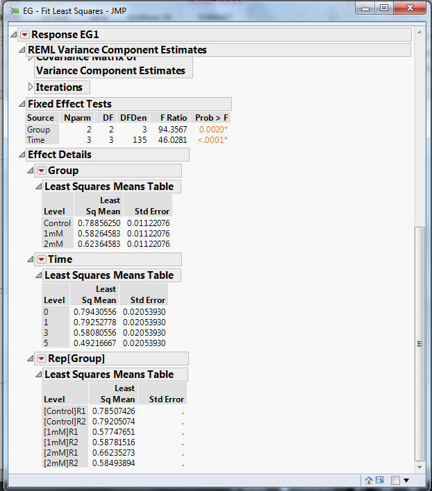

This is how I perform the analysis:
Analyze > Fir Model
EG1 to Y
Group, Rep, Time added to Construct model
Then, Rep(Group) & Random (by changing attributes to Random effect)
Method: REML
Run!
Results output looks like:

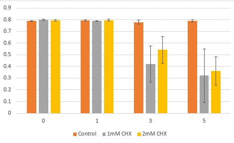

I want to draw a graph like below and denote significance difference at each tim epoint?
I want to get the mean separation for each time point separately, and denote in the graph?
Time"0": what is the mean separation of Control /1mm/2mM
Time "1": etc.
And please tell me how did you create this graph in JMP and meanseparation for eachtime point separately?

Hi Kynda,
The graph I created in Graph Builder is really just a couple of drags for you data.  Your data is set up nicely in a stack.  Drag EG1 to the Y axis, Drag Time to the X axis.  Drag Group to Color by on the right and then drag Group to Overlay on the right.
On the left side of the set control window under Bar is where you can change the view by bar style, summary and error bars.  For the graph shown below I have chosen Side by side, Auto, Mean, Standard Deviation, and Label by Variable.
Hope this helps.

Hello,
I created the graph below in Graph Builder.  The colors can be changed as needed or wanted.

I want to get the mean separation (Tukey test) for each time point separately by JMP, and denote in the graph?
Time "1": etc.

Hi Kynda,
Hope this helps.
Bill
Re: How to perform mean separation (Tukey's procedure) for sub categories / Repeated Measures Analys
I forgot to add that you will need to select the Bars icon at the top of the window once you have your data in place. The icon you need to choose is highlighted in blue at the top of the image.

My interest is to perform the Tukey test (multiple comparision /mean separation)  for each time point separately by JMP and denote in the graph.
As shown in these below bar charts, I want to show significant difference between each bar at each time points.
Image source
 For this I have to get connecting letters report for each time point (e.g. below image)
Image result for mean comparison all pairs tukey jmp letters
Image source
So my exact question is, after perform Repeated Measures Analysis (Mixed Model) ANOVA, (assume my data is normal distributed for this question), How can I perfrom multiple comparision in JMP for different time points?
Is this possible in JMP?
When I do this I get mean separation as whole, not for different time points.
Could you please help me witht his.
