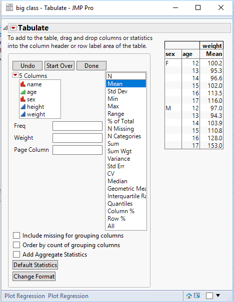

The script I included in my last response would not be added to the Fit Model.  It is a script that would be run instead of the model.  However, given your response, I suggest that what you do, is rather than working towards adding the means to the existing table, that you run a separate JMP Platform to generate the desired means.  If you run the Tablulate Platform, you can generate the means.  Below is an example, using the sample data that I have been using for the examples I have provided you.  The Tabulate Platform can be found in JMP at:
     Analyze==>Tabulate
Here are the results

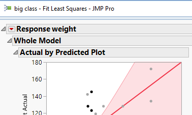

Secondly, the Window reference of "big class - Fit Least Squares"  would have to be changed to the output window name from your analysis.  This is taken directly from the output display's window name at the top left area of the output
     Analyze==>Tabulate
