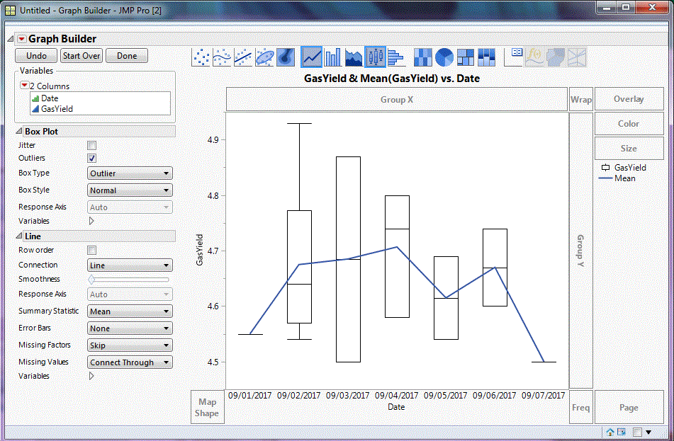

After reading your data into JMP, you can run
     Analyze==>Tabulate
to get the report table you asked for
And then to get the graph
     Graph==>Graph Builder
to generate box plots, that show the distribution for each date
mallen810b.GIFDocumentation you should look at is located under the Help pull down menu

txnelson
Re: Daily Average and Max and Min for a given date
     Analyze==>Tabulate
     Help==>Books==>Using JMP
and
     Help==>Books==>Essential Graphing
Jim
