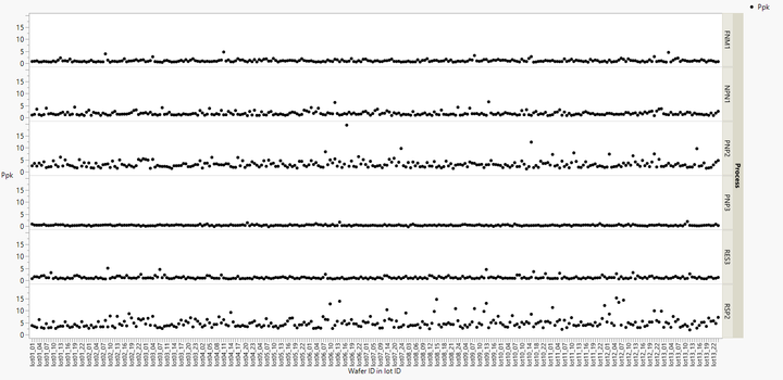

dt_wafer = Report( pc[1] )[Outline Box( "Overall Sigma Capability Summary Report" )][Table Box( 1 )] <<Make Combined Data Table;
Next I would like to produce a chart similar to the one below (or even better with Parameters in the Page option of Graph Builder) with the overall Ppk calculated (in table Capability Report) from the first part of the script as horizontal dashed line on y-axis for each parameter. I do not know how to get y-axis values from one table and use it on a chart produced from a different table so need some help on the JSL here.
When it's too good to be true, it's neither
jthi
Re: How to get Ppk per parameter and Cpk per wafer per parameter post outlier filtering?
With newer JMP versions very easy, you can just enable label for the line (not sure if this was already in JMP16):
If that doesn't exist in JMP16, then I would use reference lines and skip the updating from reference Ppk from the other table (store them to associative array instead and use that when setting the reference values).
-Jarmo

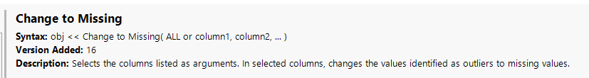

Because you have wide format table, you will have to change them to missing (use missing value codes or modify data) OR stack your data to be able to exclude rows.
Have you tried if << Change to missing does what you are looking for?
-Jarmo

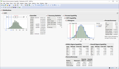

Create a single column with outliers which you can calculate the Ppk for manually (and with JMP). Change the outliers to missing, repeat calculations. Are they correct?
If I just take the first parameter and check what it looks like
I would say someone should somehow react to that. You can also pretty easily see why there are negative capability values (mean is outside of the specs).
-Jarmo

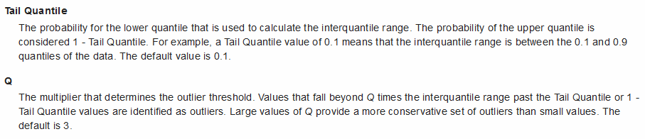

@jthi Thanks. My understanding was that Ppk's cannot be negative while Cpk's can, hence I was doubting my "Change to Missing" step. I will check my understanding. One more thing before I proceed to the second part of my question - am I applying the outlier filtering criteria (i.e. filter outside Q1/Q3 +/- 1.5xIQR) correctly?
jthi
JMP documentation has best answers to questions like that, if you can just find the correct places. Sometimes it can be fairly difficult.
In this case, most likely here Predictive and Specialized Modeling > Explore Outliers > Overview of Explore Outliers > Quantile Ra... or here Predictive and Specialized Modeling > Explore Outliers > The Explore Outliers Report > Quantile Rang...
-Jarmo
