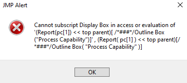

Re: How to get Ppk per parameter and Cpk per wafer per parameter post outlier filtering?
@jthi Thanks. I am on JMP 16.2. I get the following when trying to get a combined data table using your script (I get same with mine)

jthi
I don't have access to JMP16 anymore so you will have to figure that out yourself or someone else has to chime in. If I remember correctly, JMP16 doesn't create list of objects when you use By but rather one object. From there you have to find the correct table box (pick first with correct information) and you should be able to send << Make Combined Data Table to that.
-Jarmo
Will this way work?
(pc << XPath( "//OutlineBox[text()='Process Capability']//TableBox" ))[1]

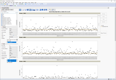

dt_wafer = Report( pc[1] )[Outline Box( "Overall Sigma Capability Summary Report" )][Table Box( 1 )] <<Make Combined Data Table;
Next I would like to produce a chart similar to the one below (or even better with Parameters in the Page option of Graph Builder) with the overall Ppk calculated (in table Capability Report) from the first part of the script as horizontal dashed line on y-axis for each parameter. I do not know how to get y-axis values from one table and use it on a chart produced from a different table so need some help on the JSL here.

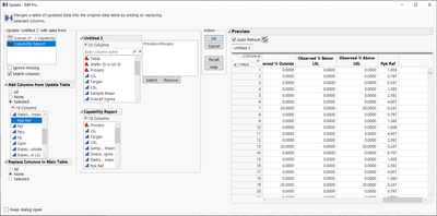

Join the values from reference data. First rename the "Ppk" column for example to "Ppk Ref", then use Update and match with Process
Then create the graph and add two columns to Y-axis: Ppk and Ppk ref. Disable Ppk ref from points and Ppk from line
