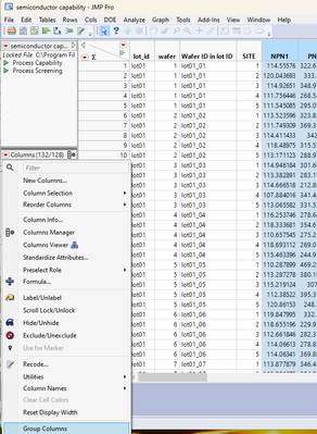

Go to
     Cols=>Column Manager
Click on the Property Down Arrow and select Spec Limits
Select all displayed columns
      Select first displayed column and then scroll down to the bottom of the list and then press the shift key and click on the last displayed column

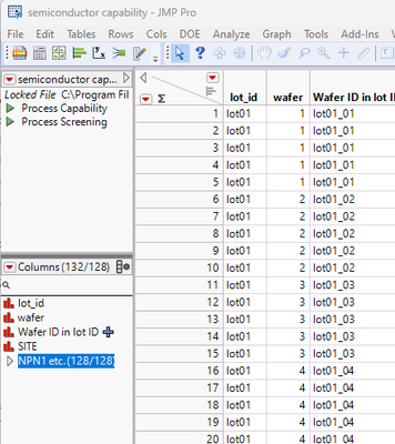

Now return to the original data table.  All of the columns with Spec Limits are now selected.
Select
     Cols=>Group Columns
or go to the red triangle in the Columns Panel and select
The columns will now be grouped

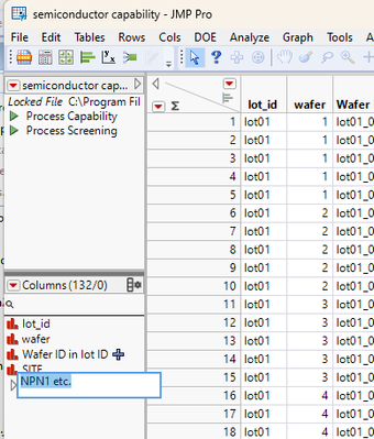

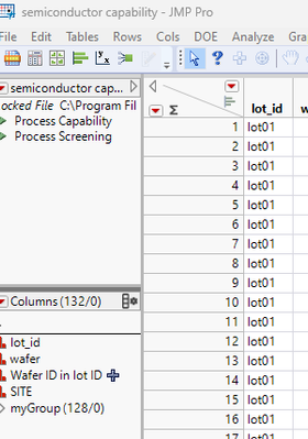

To change the name to myGroup, double click on the default name
Type in the name myGroup and press the enter key
