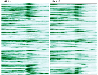

I am having an issue with heatmap binning in JMP Pro 15. My axis variable (time) is continuous and consists of 0.2s intervals. However, JMP 15 treats all increments <=1 exactly the same, plotting the heatmap with an increment of 1.
This was not a problem in JMP13....the 2 plots below are the same data, same script.
Thanks in advance for any thoughts on what's going on here.

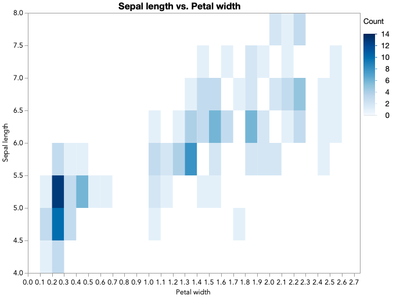

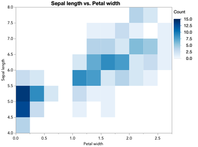

Using the Iris.jmp sample data set, we can make the following heatmap, allowing for default scaling of the bins:
Open("$SAMPLE_DATA\Iris.jmp");
Graph Builder(
	Show Control Panel( 0 ),
	Variables( X( :Petal width ), Y( :Sepal length ) ),
	Elements( Heatmap( X, Y, Legend( 7 ) ) )
This will return:

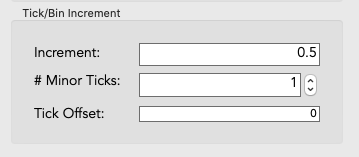

Double-clicking the X-axis, we can see the Increment and minor ticks are set such that we will get a bin on the x at every 0.25 -- the increment of 0.5 divided by 1 minor tick into 2 sections:

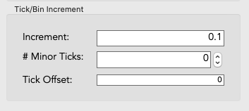

If we wanted bins at every 0.10 increment, without minor ticks, we'd use:
and that returns this for me (after I make the window a little bigger to stop the crowing on the X axis):

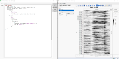

Thanks for sticking with this Julian...happy to share a data file. I've left a script for producing the heatmap in the table.
As you can see, the script specificies an increment of 0.2, but produces a heatmap with increment of 1. For me this problem is specific to JMP 15 Pro (works fine in JMP 13).
Also, hovering over a point in the heatmap confirms that each is an average of 5 rows.
