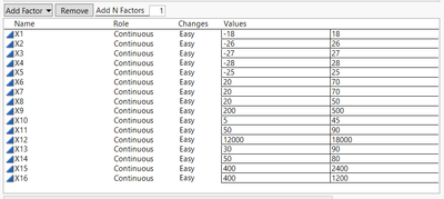

Hi @MarkovVaribles1,
I'm sorry but I can't understand some of the constraints :
  • "If X13 is chosen, none of the X14, X15, and X16 can be selected." : What do you mean by "chosen" and "not selected" ? All the factors mentioned here have low levels different from 0 in your design, so I don't understand how to "choose" and "not select" some of the factors. Are these factors linked to each others (like mixture factors with constraints) ?
  • "Further X14*X15 <= 1200" : Since the low levels for these factors are respectively 50 and 400 (50x400 = 20000), I don't see how to take into account this constraint... Either there is a problem in the factor levels or in the maximum value constraint.
  • "Finally X13/X10 must be whole number." : Are you interested in individual factors X13 and X10 or only on their ratio/relative values ? If it's the second option, as mentioned in my previous answers, you can perhaps include only one factor X13/X10 instead of two individuals factors.
As noted by @fja, providing more information and context can help other users guide you or giving you some advices.
Here are some based on what I may have understood from your topic :
  • Since you have a quite high number of factors (13), I guess your primary objective would be to sort out significant from non-significant factors ? In this case, a D-optimal design (in the menu "Custom Design") could help you design a DoE that match your expectations (screening main effects of the input factors).
Concerning your specific cases for some factors :
  • "Variable X1 and X2 (both numeric) cannot be in the experiment at the same time" : I see two potential solutions (to be tested/confirmed) : you could either use a "Disallowed combinations filter" in your DoE if low levels for these factors are at 0, or more simply create a categorical column "choice" with two levels (X1, X2) and a continuous column for the quantity/number of this variable to be tested. This should naturally respect your constraint of having only one of the variables in the experiment (X1 OR X2).
  • "If X2 is selected then the X2*X3 <= 1200" : This may be a good case for using "Disallowed combinations filter", with the creation of a formula column X2*X3 in order to create the constraints. Or the use of covariates/candidate set may also be an alternative, in order to let JMP "pick" the most informative experiments from an "authorized" set of experiments datatable.
  • "Furthermore, the ratio of X6 to X5 must be a whole number" : For this case, why not creating directly a factor X6/X5 if you are more interested in the ratio value than in the concrete numeric values from X5 and X6 ? With a screening design, you could set up low and high levels so that this ratio factor could only be a whole number, for example with a low level set at 1 and high level set at 2, 3 or 4...
These are my thoughts at the moment, some may be inaccurate or irrelevant depending on the missing context/objectives, but I hope some will help you in your design creation.

Re: DOE
Hi Victor,
Your suggested solution is much appreciated and I thank you for taking your time to help here. Only thing is with the ratio of the two factors being an integer. The two factors are Low Frequency and High Frequency of the power, both of which need to be specified for the experiment within certain operational range.
Thanks again!

I tried to create the design and I get error messages!
Here is the actual list of variables below.
Constraints: either if X13 is chosen, none of the X14, X15, and X16 can be selected. X14, X15, and X16 must be together in which case X13 is out. Further X14*X15 <= 1200. Finally X13/X10 must be whole number.
The goal of the DOE is to minimize variation of response across wafer (maximize uniformity).
Thank you for your time!

Re: DOE
Hi Victor,
Sorry I am not clear, so I try to explain differently.
1. If X13 is chosen, none of the X14, X15, and X16 can be selected: what I meant here is that the engineer has two power supplies: one associated with X13 and the other one with X14, X15 and X16. He can only choose one power supply per experiment. If he chooses power supply 1, then he only has X13, all other variables in place (excluding X13, X14, X15). If he chooses power supply 2 then X14, X15 and X16 come into play and X13 is no longer a variable.
2. "Further X14*X15 <= 1200": I should have mentioned that X14 is in percentage ... my apologies
3. "Finally X13/X10 must be whole number": here the interest is in the X13 and X10, and the engineer is requesting that we design the experiment keeping this in mind, so both of them need to be in the design.
In regards to item 1, I thought maybe one approach is just having two designs, one for each power supply. This may not be the best design and the reason I am seeking advice.
Thanks again for your time
