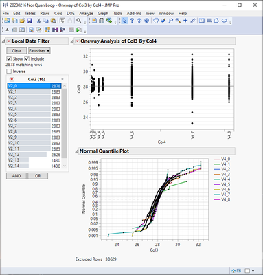

What are you going to do with those charts 16 reports (and then 17 tables you will have open)? I'm asking because Local Data Filter could be one option depending on what you are trying to do
Oneway(
	Y(:Col3),
	X(:Col4),
	Plot Quantile by Actual(1),
	Line of Fit(0),
	Normal Quantile Label(0),
	Local Data Filter(
		Add Filter(
			columns(:Col2),
			Where(:Col2 == "V2_0"),
			Display(:Col2, N Items(15))
	SendToReport(
		Dispatch(
			"1",
			ScaleBox,
			{Label Row({Show Major Grid(1), Show Minor Grid(1)})}
		Dispatch(
			{"Normal Quantile Plot"},
			"1",
			ScaleBox,
		Dispatch(
			"2",
			ScaleBox,
			{Min(0.000347463516330788), Max(0.999652536483669), Inc(0.1),
			Minor Ticks(0), Add Ref Line(0.5, "Dashed", "Black", "", 1)}
		Dispatch(
			"Oneway QuantilePlot",
			FrameBox,
			{Marker Size(1), Marker Drawing Mode("Normal")}

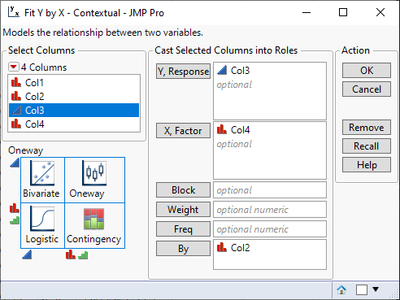

Other simple solution might be using By
After exploring those options I would start thinking about looping if needed.
-Jarmo
WoHNY
Level IV
Re: JMP16 Generate Loop to Run Repeating Charts
Thank you for the response. As I often say, if it was a snake it would have bit me! It was staring me right on the face for this one. Thanks for highlighting the "By" field for this case. I also have a question about the Graph > Graph Builder path for box plots if I don't want to utilize the Page option but run individual charts but I'll open another question for that. Thanks again.
