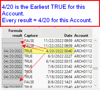

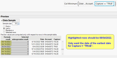

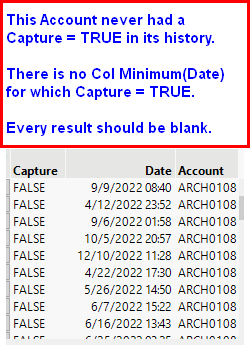

Thierry, thank you for your reply.  I mis-specified my request, and your formula works for my misspecification. Below are screenshots of the logic I am looking for, and the associated small data set is attached.
Corrected request -
1. Within an Account, find the Earliest Date that has Capture = TRUE.
==> maybe this Date is stored in a temporary variable?
2. Fill in this Earliest Date for every row of this Account.
3. If the Account never had a historical TRUE, leave every row blank.
==> signals that this Account never had any success.
Example of an Account that has Capture = TRUE in its history.
Example of an Account that never has Capture = TRUE in its history.

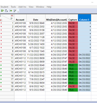

Given your abbreviated sample table, here is the formula that should work
Col Min( If( :Capture == "TRUE", :Date, . ), :Account )

Hi,
You are mostly there. Try the following:
If (:Capture == "TRUE", Col Minimum (:Date, :Account, :Capture), .)

Thank you - I have tested your solution on a handful of accounts, and so far, it is working perfectly.  regards, Paul
