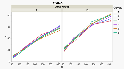

I'm wanting to use Graph Builder to create a graph like this (copied from the Fit Curve dissolution model free comparison report)
I cannot seem to do this in graph builder.  Any suggestions?
The graph needs to show each curve (specified as CurveID in the data table).
The graph needs to show the average curve by group (Curve Group).
The error bars are not necessary, but would be nice to have.

I got it. I split the data based on Curve Group so Y A and Y B are their own columns. Then put them both on Y. I added line element twice and use CurveID as Overlay.  For one of the lines I removed the Overlay Variable to get the mean for A and B.  The rest was manipulating thickness and colors of lines via legend and Customize.
I attached split table.

is the best I can get, so far.

Have you tried adding line element a second time and then manipulating the variables like so:

That's closer, but still cannot overlay the two curve groups.
Re: Create Curve Plots with Overall Average Curve and Individual Replicate Curves
Taking it one step further and manipulating graph colors and transparencies:
using JMP 18.1.2 and here is the script to recreate

Ok, that works.  Still a bit clunky.  And in my actual analysis project that I want to do this for, I have dozens of curve groups, and I would want to be able to filter on the curve group...which would require a very wide split table, but would not allow easily filtering on curve group.  It would be nice to be able to this with a stacked table.
