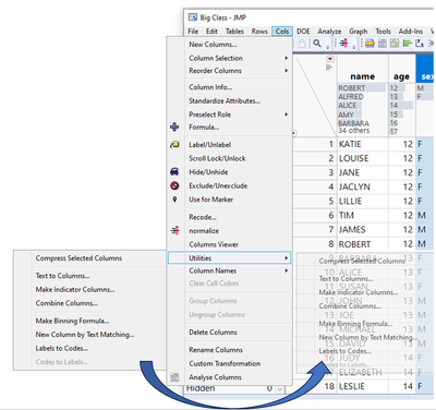

The submenus of my Jmp installation always open to the left of the main menu:
Where is the setting to move submenus to the "right"?
add-on question: what is the background of them opening on the wrong side?

It has been my experience that if you move the window you are selecting the man menu option too, to the left edge of your monitor screen, JMP will open the submenus to the right

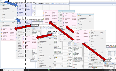

Re: Collection of "funny" JSL newbie questions
Good point, I hadn't noticed that before.
When moving the Jmp window from the left to the right, there is already a small area on the left of the screen where menus open to the right ☛ (highlighted in blue).
In the remaining area of the screen the windows are opened to the left ☚ (highlighted in red).
Almost seems that as soon as there is enough space on the left - the submenu will flip to the left.

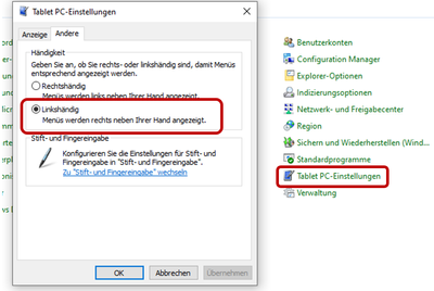

the workaround:  switch the display to left handed
