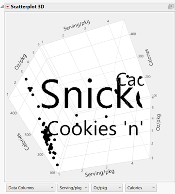

Hello everybody,
When we increase the marker size of a Scatterplot 3D, the labels attached increase as well and it impacts the chart readibility.
Is there a way to increase only the marker size?

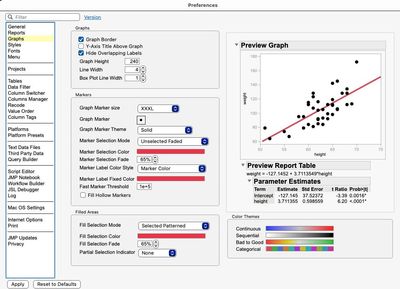

Have you tried to set marker size in preferences?

I don't see a difference is the 3D Scatter plot when I change the preferences (tested it JMP 17 & 18).
