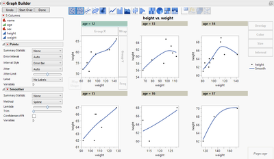

I could use some help on why I can't get the title of the 1st panel in this Graph builder
with this code
report=current report();
test=(report<< XPath("(//OutlineBox[text()='Graph Builder']//GraphBuilderGroupBox)[2]"))<<get title;
Thanks for any suggestions!
Steve

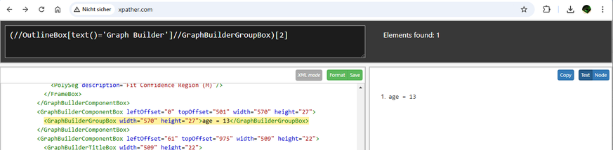

With some Xpath Parsers, one already gets the content of the node
https://www.w3schools.com/xml/xpath_examples.asp
http://xpather.com/
E.g. after pasting the result of
xml= current report() << Get XML;
into http://xpather.com/ and searching for
one gets: "age = 13"
JMP and others
https://www.freeformatter.com/xpath-tester.html
https://magictool.ai/tool/xpath-tester/de/
http://xpather.com/ (setting: node)
return the surrounding "object".
So, one has to retrieve the content of the node in a separate step ...
I guess there is an easier way than this one ...
Till somebody posts it, you can use
test=(report<< XPath("(//OutlineBox[text()='Graph Builder']//GraphBuilderGroupBox)[2]"))[1];
xml= test << Get XML;
Regex (xml, ">(.*?)<\/GraphBuilderGroupBox>", "\1")

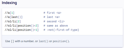

by the way - thank you for the trick:
direct indexing via [2] is possible in XPath - cool, thanks!!!

The reason for the ask was that I need to have different axis settings for different panels but since the # of panels change the hard coding of the axis range from the saved script Graph Builder makes (e.g. Scalebox(2)) causes the charts to be all messed up on later times when I run it. So I can now use this code to loop through the panels, check what is there, and then set the axis min and max correctly.  Still a lot of painful coding to do but at least now I have a path!
