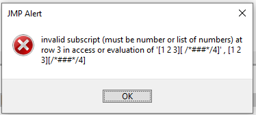

@Sarah-Sylvestre , could you please add to the wish:
- return "." if the vector has less entries than the index
[1 2 3][4] = .
At the moment, JMP throws an error and stops:
The error message is quite misleading.
Why does it say invalid subscript (must be number ...)
4 IS a number, right?
