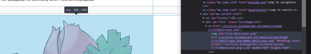

hogi
Level XIII
Re: Add images from URLs in a column
this is cool:
