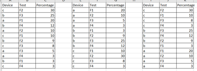

I have been trying to organize a set of data to group by the device column (ie all the a's are together, b's, etc), but sort them by the percent failed (ie c, F2 would be first followed by the rest of the c rows, then b, F3, and so on) similar to the picture below. When I sort by percent I get the left most table, by device I get the middle table, but I am not sure how to combine the filtering to get the right most table.
Any insights would be greatly appreciated! Thank you.

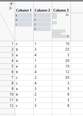

Starting point:
Sort Descending by Column3
Sort Descending by Column1

For example:

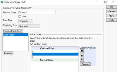

Then you could "cheat" and pre-define the device order:

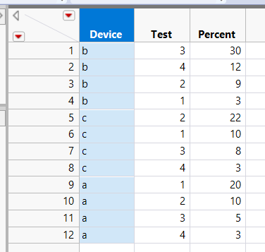

or add a column with the additional info:
By the way, you can also sort in a single step by first selecting both columns and then clicking on sort/descending.
The columns are used from left to right, so you have to place the main category column left of the subcategory column:
