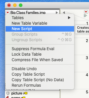

Then, let’s copy the text for that script and go back to the data table. Select New Script from the red triangle menu in the uppermost left corner of the data table.
Paste the script text into the dialog, give it a useful name and click OK.
If you’re following along, you should see your report in the script area of the data table. If you run it, you should get something like this:
