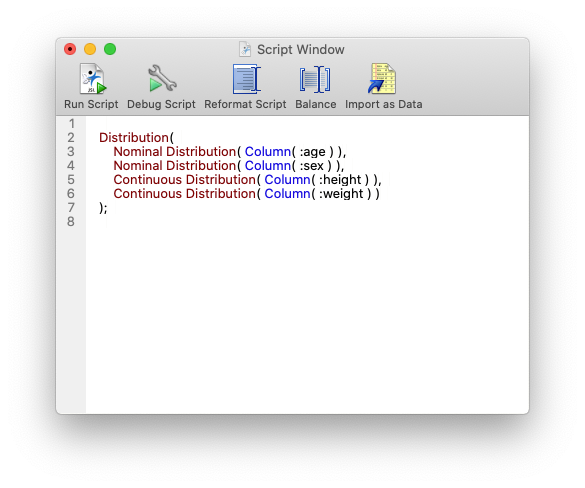

The next entry in the Save Script to… red triangle menu, we are going to cover what is probably the most instructive of the three I’m discussing. Saving a script to a script window does just what it says: It creates a Script Editor window (we’re going to go deeper on the Script Editor in the next episode) and populates it with JMP-generated JSL to recreate whatever was in the window you were working from. The important point with this entry is that you can study the code and learn from what JMP generated.
Let’s look at a trivial example using Big Class again. Go ahead and click the green button next to your saved script to rerun the analysis. Then, in the report window, select Save Script > To Script Window from the red triangle menu. Now, look at what JMP has written in the Script Window.
JMP has created a Distribution Report: Distribution(…);. JMP has put two Nominal Distribution subgroups into the report: Nominal Distribution(Column(…)) and two Continuous Distribution subgroups: Continuous Distribution(Column(…)). At the end of the script, JMP has put an incredibly important piece of code: the “;”. It’s called the “Glue Operator” and we’ll cover it in more detail in the next episode. For now, you just need to know that it’s a way to signal to JMP when it’s running the code that another instruction is coming. The fact that JMP puts that on the end automatically makes the novice scripter’s life a lot less complicated.
The last point that makes this entry so useful is what happens if you leave that script window open. Go ahead and close the Distribution Platform, but leave your Script Editor open. Now, using the open data table, create a Fit Y by X report (under Analyze) using Height as the X variable and Weight as the Y variable.
Next, select Save Script to Script Window again.
Did you notice how the window was updated with another entry? That script will now recreate the two windows you were just working with, once you know how to run one. Speaking of which…
