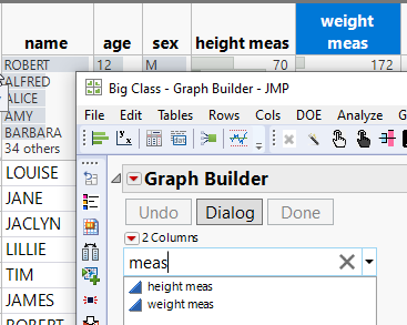

The Filter menu in the column list is very useful. The user just has to add tiny identifiers to the column names to get a handle to select a set of columns (much more flexible that grouping :).
For larger data tables, it could help to have an automatic way to add strings to column names.

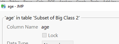

Concerning Recoding selected column names, this approach doesn't work
- unfortunately, Recode Column Names is disabled for linked subsets.
Along this line, manual editing of the column name is also disabled:
