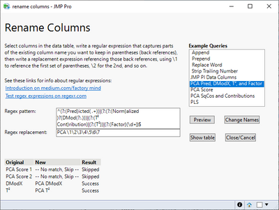

Up to now, I used Rename Columns from the Jmp Scripting tools Add-In :
Scripting Tools

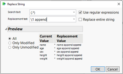

Replace String from the Recode Column Names menu looks similar.
a)  Is there an option to apply the change just to some selected columns?
b) How must the Regex expression look like to add a string to the existing column names?
   Using the same syntax as in Jmp Scripting tools/Rename Columns,  the appended string is added twice:

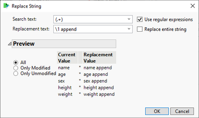

Re: Append a string to column names
For regex try using + instead of *
-Jarmo

Level XIII
great, thanks @jthi .
