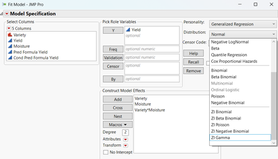

There are already some zero-inflated modeling possibilities in the platform "Fit Model" :
When you choose "Generalized Regression", at the end of the options for the Distribution, you can find some zero-inflated distributions type : binomial, beta binomial, Poisson, Gamma, ...
You can find more infos about the available distributions in this platform here : Specify a Distribution (jmp.com)
Maybe the distributions proposed won't be of any help to you, but just wanted to inform you in case it could help you :)

@Aziza also, to clarify, the ZI models that @Victor_G describes in Generalized Regression and are available in JMP Pro.
