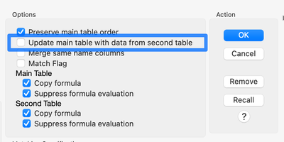

Hey @hogi ,
Is this the option you're looking for?
@julian
hogi
Level XIII
Hi @julian - the name sound promising, yes :)
But I fear that this function differs from what I want to do:
What I want to do:
@hogi wrote:
1) I want to add a column to the table
2) the platform should update the main table instead of generating a new one.
But according to the documentation:
which means, with Update main table with data from second table,
- no columns are added.
- a new data table is created (no change to std. Tables/Join behavior )
The first issue can be fixed by disabling the option Update main table with data from second table.
To get a solution for the second issue, I wrote this wish.

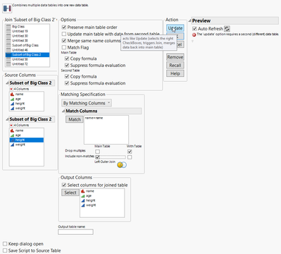

The new Join platform could look like this:
Names Default To HERE(1);
dt = current data table();
dtList1 = Associative Array(get data table list());
likeUpdate=Function({},
	joinupdate[PanelBox(3)][checkBoxBox(3)] << set (1,1);
	joinupdate[PanelBox(3)][checkBoxBox(4)] << set (1,0);
	joinupdate[PanelBox(4)][checkBoxBox(1)] << set (1,0);
	joinupdate[PanelBox(4)][checkBoxBox(2)] << set (1,1);
	joinupdate[PanelBox(4)][checkBoxBox(3)] << set (1,1);
	joinupdate[PanelBox(4)][checkBoxBox(4)] << set (1,0);
	joinupdate[PanelBox(5)][checkBoxBox(1)] << set (1,1);
	NCols1= NItems(joinupdate[PanelBox(2)][ListBoxBox(1)]<< get items());
	foreach ({col},1::NCols1,	joinupdate[PanelBox(2)][ListBoxBox(1)] << set selected (col));
	joinupdate[PanelBox(5)][ButtonBox(1)] << click;
	joinupdate[PanelBox(6)][ButtonBox(2)] << click;
	dtList2 = Associative Array(get data table list());
	dtlist2 << remove (dtList1);
	dtNew=(dtList2 << get keys())[1];
	dt << select all rows() << delete  rows();
	dt << concatenate (dtNew, Append to first table);
Try(joinUpdate << close window());
joinupdate=new window("join+",dt<< join);
joinUpdate[PanelBox(6)][Lineup Box( 1 )] << prepend( mb = MouseBox( Button Box( "Update", likeUpdate() ) ) );
mb << settooltip( "acts like Update (selects the right CheckBoxes, triggers Join, merges data back into main table)" );
