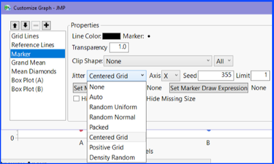

We did discover by doing a right-click and select Customize > Marker, that the option to change the jitter is shown
Oneway(
	Y( :Data ),
	X( :Levels ),
	Means( 1 ),
	Box Plots( 1 ),
	Mean Diamonds( 1 ),
	X Axis Proportional( 0 ),
	Points Jittered( 1 ),
	SendToReport(
		Dispatch(
			"Oneway Plot",
			FrameBox,
			{Frame Size( 607, 243 ), DispatchSeg(
				Marker Seg( 1 ),
				Set Jitter( "Random Uniform", "X", 1, 0, 355 )

Thanks for showing where the setting is hidden :)
