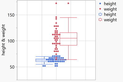

hogi
Level XIII
related issue:
Boxplot with points, showing the points in associated Box
Names Default to Here(1);
Graph Builder(
	Variables( Y( :height ), Y( :weight, Position( 1 ) ) ),
	Elements(
		Points( Y( 1 ), Y( 2 ), Legend( 3 ) ),
		Box Plot( Y( 1 ), Y( 2 ), Legend( 4 ) )
