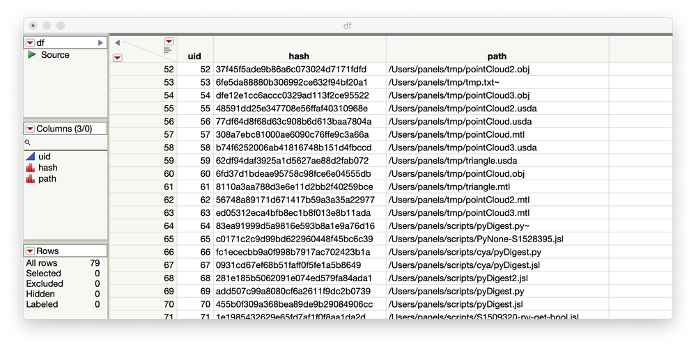

A MD5 checksum is computed for each file and that along with the path is inserted into the sqlite3 database, then the sqlite3 table is imported into JMP as a Data Table.
Screen Shot 2021-03-09 at 4.14.29 PM.pngRe-running the script just appends another directory's worth of information into the database.  Also demonstrated is an example of fully specifying dll and sys.path in the Python Init().
