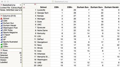

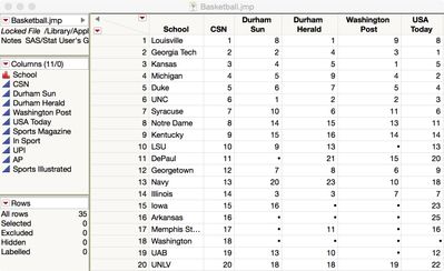

The first example is based on the ratings of college basketball teams by various news sources in the Basketball data table from the Sample Data folder.
Note:  the MCA platform in JMP requires that the response columns be stacked first. This script accepts the data in the format above, applies the data transformation, and then stacks the data automatically before launching the MCA platform.

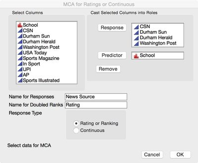

  1. Open your multivariate data table in the format shown above.
  2. Open and run the script.
  3. Select the response data columns and click Response. (CSN through Sports Illustrated in this case)
  4. Select the predictor data column and click Predictor. (School in this case)
  5. Enter the collective name for the responses. (News Source in this case)
  6. Enter the name for the data values. (Rating in this case)
  7. Select Rating or Ranking for the Response Type in this case.
  8. Click OK.

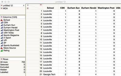

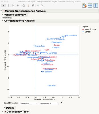

The responses are individually ranked and then doubled to produce a negative pole and a positive pole for each response.
These new doublings are then stacked for the MCA.
Finally, the MCA platform is launched with the doubles and the predictor for interpretation.

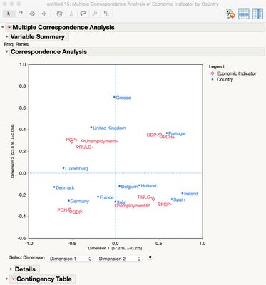

The various news sources define the space and their doubles appear in opposite directions from the origin of the plot. Note that about 43% of the inertia in the original ten dimensions is represented in the first two dimensions shown here. It might be worthwhile to pursue more insight using the 3D Correspondence Analysis feature of the MCA platform.

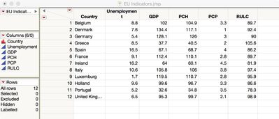

The second example is based on European Union economic indicators. (See attachment below.)

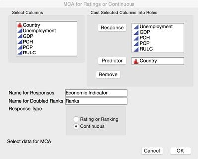

Follow the same steps as outline above but use the columns in the EU Indicators data table as shown below.
Be sure to select Continuous as the Response Type before clicking OK.
In this example, about 80% of the inertia is displayed by the first two dimensions.

I have been working last days with a problem and I see for the example of EU Indicators that Portugal for example and according the data is close from GDP+ when in reality is the one with the lower value.
My question is if there is an change in the signs.
My best regards
Jose Montanha
Hi Mark,
I just dicovered your script yesterday.  It's just what I need because it not only gives me a tool but because the resulting map confirmed what I did on my own before I found your script.  I'm using rating data and what your map, based on your script, shows for my data and what mine shows agree, which makes me feel good.  But I have a problem with the maps -- I'm not convinced they're correct.  If you look at Greenarce's presentation on recoding at www.econ.upf.edu/~michael/METU/METU6_BW.pdf   you'll see that a straight line connecting the polar opposite points should pass through the origin.  He spends some time discussing this and its importance.  In the JMP map, a straight line does not pass through the origin.  So there is a problem.  Any thoughts on this?
Thanks,
