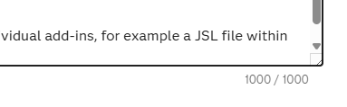

hogi
@Justin_Chilton
hm, better?
Looking at the detailed "conversations" in this post, one gets a good outlook how DIFFERENT "communications" will be in the the future:
- no formatting
- no possibility to post screenshots
- no possibility to post (JSL) code
- no possibility to cite other users
- no possibility to @ mention other post
and @tsl 's question will end with
hogi_1-1765260442453.png,
... just a few characters before the question starts.
