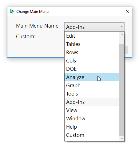

  1. Right-click on the top item in the Menu Item Tree and select "Change Main Menu."
  2. From the "Change Main Menu" window, select the menu from the ComboBox that you would like your menu item(s) to be placed.Change Main Menu.png

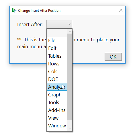

  3. If there is a value already set in the "Insert After" property (and the previous menu was a custom one), you will be prompted to change the property to a new value. The item you select here will determine where your custom menu will be placed within the Main Menu bar.Change Insert After.PNG
    If you were not prompted for an Insert After value, you can right-click on the top item in the Menu Item Tree and select "Change Insert After" to update this value.

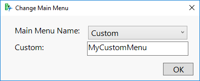

  2. From the "Change Main Menu" window, select "Custom" from the ComboBox and type the name of your desired Menu in the TextEditBox, as shown below.Change to Custom Menu.png

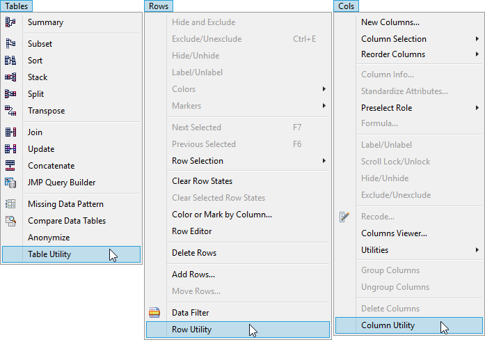

With Add-In Manager, you can now create a single add-in that creates multiple menu items within multiple different main menus. This might be useful if you are creating an add-in that performs multiple tasks that fit in different areas. For example, a data table utilities add-in might call for a menu item with the Tables, Rows, and/or Cols menus.
  1. To add an additional main menu to your add-in, click the Red Triangle Menu next to the "Menu Item Tree" on the Menu Items tab and select Add Top-Level Main Menu.
  2. Next, select the main menu you would like the new menu to represent, as shown in the above sections. Below, I have added two additional main menus.Multiple Main Menus.png
  3. Once you have added all of the desired main menus and their containing menu items, build the add-in and see the three menu items in multiple main menus.Multiple Main Menus2.png

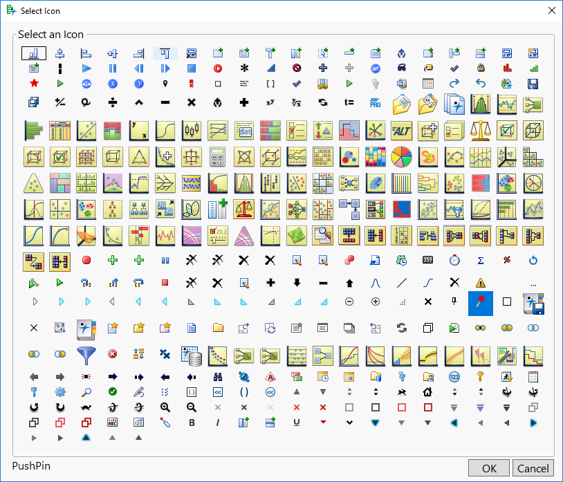

  1. On the Menu Items tab, select a command and click the Select button within the Icon section.
  3. You will see a preview of the icon in the Menu Item Tree.Built-In Icon 2.PNG

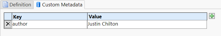

Custom metadata can be added by clicking the green plus icon next to the table on the Custom Metadata tab (within the General Info tab).Add Custom Metadata.png
