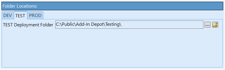

If you need one or more of your users to test out a particular build of your add-in, but you're not quite ready to push it out to everyone, you can deploy your add-in to the TEST deployment location and provide the path to install this add-in to the user(s).
Before deploying an add-in to a TEST location, ensure that you have a TEST deployment location defined in the TEST tab of the Folder Locations section. Test Location.png
Click the Deploy dropdown button and select "Deploy TEST" to copy the add-in to the TEST Deployment Folder. The TEST add-in will get overwritten each time it is deployed to the TEST deployment folder.Deploy TEST.png

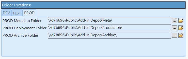

Before deploying an add-in to a PROD location, ensure that you have a PROD deployment location defined in the PROD tab of the Folder Locations section. If you use the update check script, make sure that the PROD Metadata Folder uses a server path as users will need to be able to access this path when checking for updates.PROD Location.png
Click the Deploy dropdown button and select "Deploy PROD" to copy the add-in to the PROD Deployment Folder with a state set to "PROD." The previous PROD add-in will get archived to the PROD Archive folder and the new PROD add-in will take its place.
