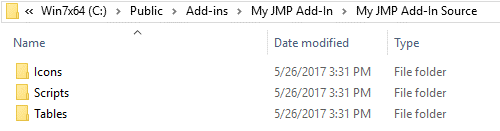

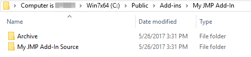

Step 1: Create Development Source Folder
This step is just one suggested way to approach organizing your add-in files. You can do this part however works best for you.
  • Create a folder for your add-in. This folder will contain all versions of the add-in as well as the source files. Optionally create an Archive folder if you would like Add-In Manager to archive add-ins for you each time you build a new version.Destination FolderDestination Folder
  • Optionally, within the source folder, create subfolders to group different types of files separately. This may be unnecessary for small add-ins, but can be very useful when there are many files used in a single add-in.
Source FolderSource Folder

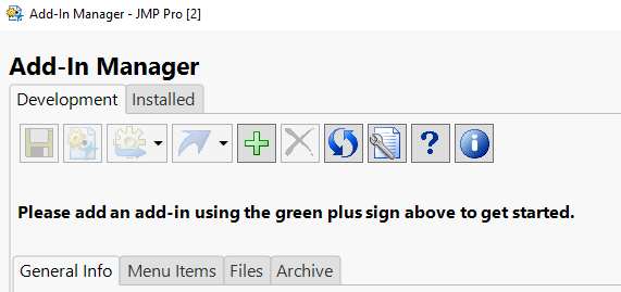

  • Before you define any add-ins, there will be a message as shown below.
  • Click the New Add-In button Add.gifAdd.gif to define a new add-in.

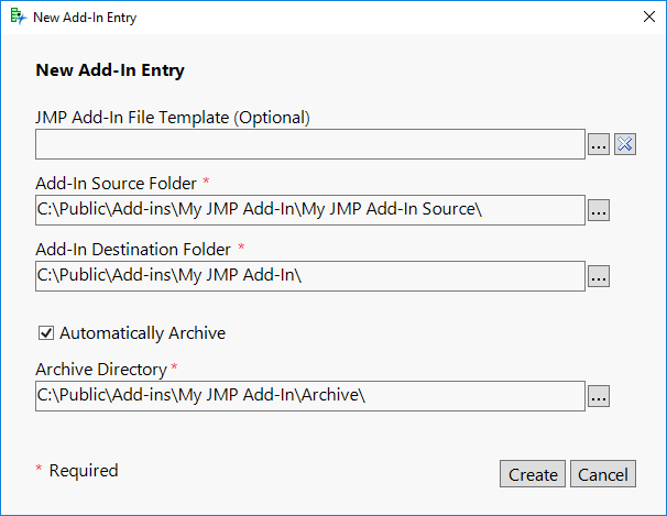

  • Click the ellipsis buttons to add both a source and destination folders. You can optionally turn on archiving for your add-in and provide an archive folder.
  • If there was not an addin.def file located in the source folder, you will be prompted for a name and ID for the add-in. Enter a name and an ID and click “Create.”

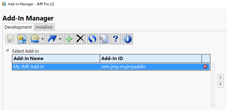

  • The add-in has now successfully been defined in Add-In Manager.

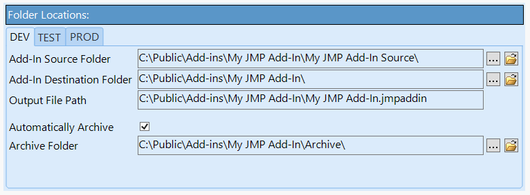

  • At the bottom of the tab, there is a Folder Locations section. Here you can update your source/destination folders as well as archive settings.
Folder LocationsFolder Locations
  • After updating, press the Save button Save.gifSave.gif to save this information.

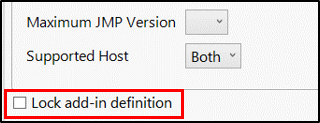

  • Optionally, you can click the “Lock add-in definition” check box to ensure no changes are made to your addin.def file.Lock Definition.pngLock Definition.png

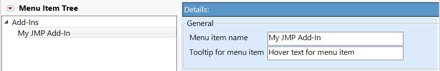

  • Rename the menu item and optionally give it a tooltip.Name-Tooltip.pngName-Tooltip.png

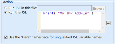

  • Add an action to run for this command either using a file or pasting the JSL in directly. In this example, we paste the script into the Run this JSL option as shown below. To do this, click the “…” button, paste the JSL into the script editor, and press OK. The results are shown below.

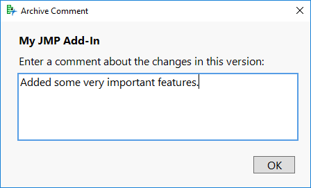

  • If you have automatic archiving turned on, and the Prompt for Comment preference set, you will get a pop-up window with a text box for a comment. This is a good place to store information about what has changed in this specific build of the add-in.
