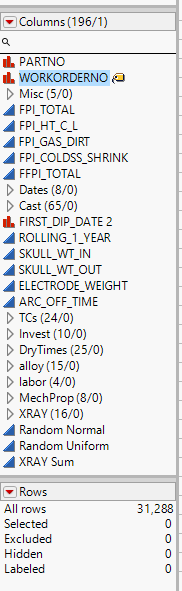

Hey @jthi ,
Here is an overview of the main table:
and heres the ref table:

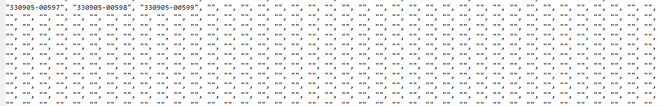

So most the columns are full of "missing data"/blanks due to the few columns that have a ton of bad data.
Make me wonder if having all these blanks in the vlist is causing the slow down:
jthi
Re: "Get rows where" is taking way to long
Most likely it will cause a slowdown, especially if the value isn't found from the list
