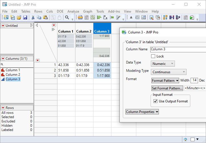

Re: Time durations with milliseconds - custom Format pattern
If you had "properly" formatted data JMP could handle this (those rows which have no minutes should have 0: at the start). Column 3 is a copy of Column 2 with format pattern applied with three decimals
I think you have to create formula to convert your strings to either directly to seconds or to some format which JMP could understand
-Jarmo
