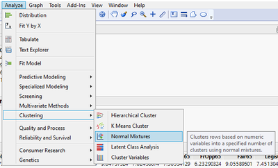

I think it's useful to drop this image here for others who might come across this post,
The "Normal Mixtures" platform does Latent Profile Analysis. You can find it under Analyze > Clustering,

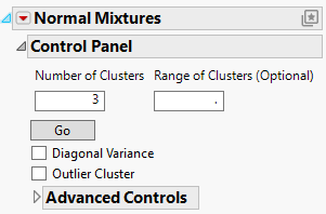

After selecting the variables you want to use to launch the platform, you'll find a Control Panel that allows you to select the range of clusters to extract so you can compare their fit (based on BIC or AICc) and decide which is best,
You should consider whether you want to restrict the covariances between variables to be zero. If you do, you should check the "Diagonal Variance" box. Doing so often helps with model estimation (depending on the data). The Advanced Controls allow you to change the number of random starts (Tours) to make sure you don't land on a local solution.
Once you have the cluster solutions, you'll find it useful to look at biplots and Parallel Coordinate Plots using the red triangle menu options,
