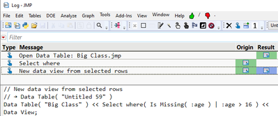

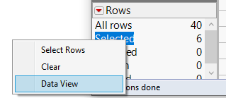

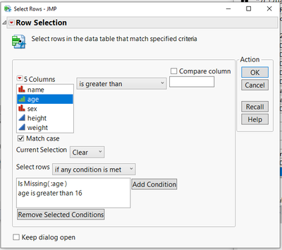

The cool thing in JMP: jou don't have to know any scripting, you can just use the GUI and your mouse.
Then after executing the steps, you can go to the advanced log and check the code ...
  1. Rows/ Row Selection/ Select Where (Ctrl + W)
  2. open data view for selected rows:
-  check the log:
Jmp understands what you want - and even combines the two steps to a single line of code:
-  check the log:
