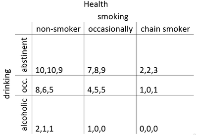

I have created a full factorial design with two X variables and one response value (Health as a function of your drinking and smoking habits, see enclosed files).
When I generate the report, the lack-of-fit test is greyed out. But why? The fitting-linear-models-pdf from the jmp-help says:

I have 3 replicated points for every X variable and 27 observations which is a greater number than the estimated parameters. So why can't I compute the LoF-test?
